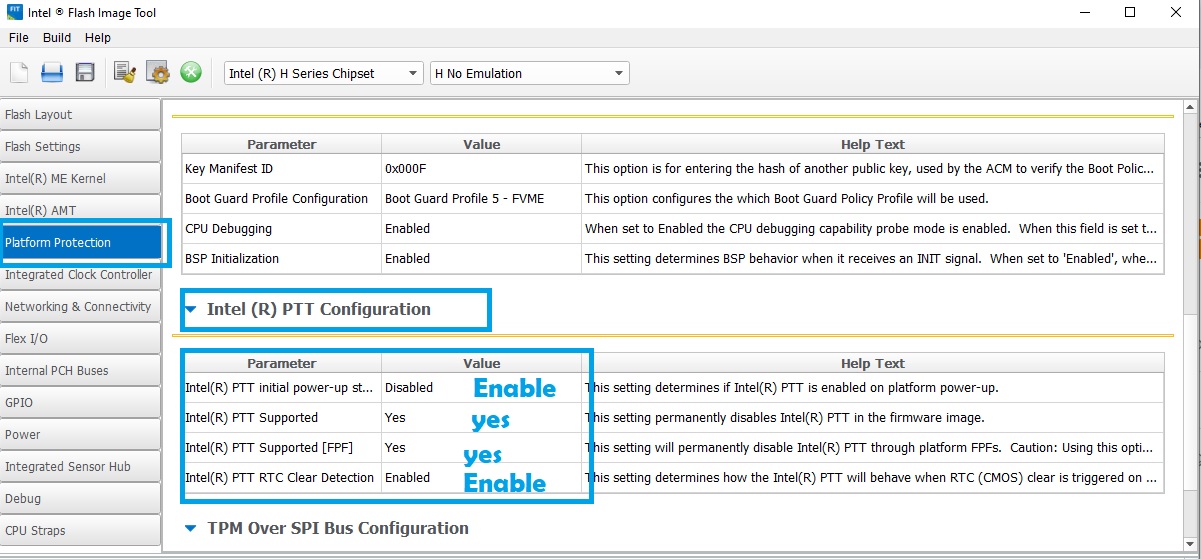

🧩 Make Necessary Changes in FITC:
  1. Go to Build > Build Settings ➤ Change "Generate Intermediate Files" from Yes to No
  2.  Navigate to Platform Protection > Intel® PTT Configuration ➤ Make sure all values are set to "Yes" or "Enabled"
If all values are already enabled and the TPM error still exists, it could be a hardware issue (e.g., damaged TPM chip). You may need to replace the TPM IC.
💾 Build & Flash the Modified BIOS:
  1. After changes are made, return to the Build tab and click "Build Image"
  2. (Optional) You may also clean the CSME (Converged Security and Management Engine) region before flashing
  3. Flash the final BIOS image back to your motherboard using a BIOS programmer.
